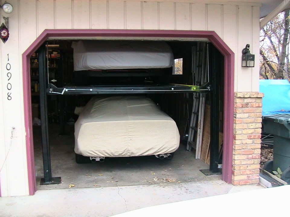

I have a ranch hose with nothing above the garage area with the exception of attic area.
My original garage celing height was 8'4" I looked into my attic and realized I could remove the garage ceiling and install collar ties to hold the structure together. There was a ratio of how long the roof beams were,what size they were and what my roof pictch was and what the total span was and that told me how far down from the peak the collar ties had to be.I was able to fing this information in a home building text book that refrenced structual building with dimentional lumber. I think I am at 10'6" from the floor to the bottom of my collar ties. I had to install a special lift style gargage door ,I think it was called a roof rider it follow my roof line perfectly.
I am double stacking cars with great sucsess. Lowering the floor opens up other problems.
Let me know how I can help
Here is how I modded my rafters to get the max lift with my 4post just to give you some ideas then I cut out the old 2X6 and removed the door opener
Now I can stand under the car to work on it and I am 6ft tall
I now put 3 cars in my two car garage
