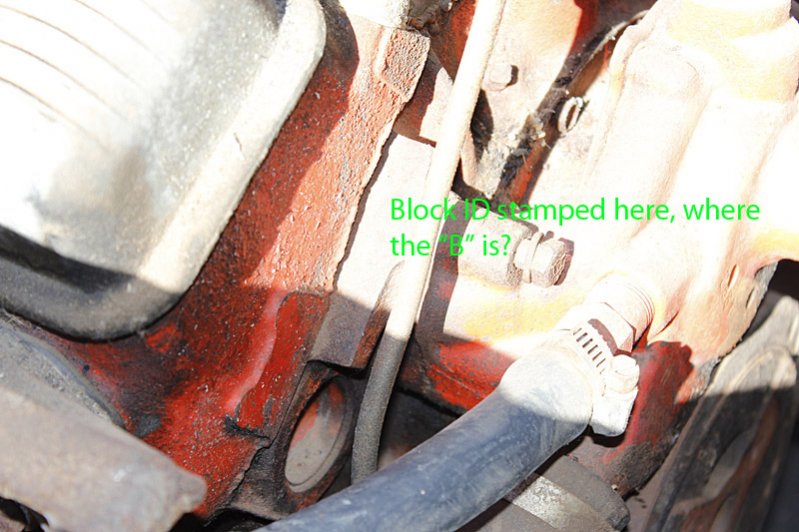

Engine code
So I looked for the engine code. Either looked in the wrong spot or have my doubts it is there. Here is a photo of where I thought it would be. Maybe I just need to clean the flat surface off to see what is there. In the photo shouldn't the numbers be on that flat surface where the letter "B" in the word Block is?
That's exactly where it should be. If it's blank most likely the block has been 'decked' during an overhaul which would have removed the info.
I am going to have to go look again. But what does "decked" mean? Never heard of that.
A squirt of WD40 and a little elbow grease with an old toothbrush should allow you to read the number, if there is no number it is a replacement engine that wasn't stamped.

Shaving the block
A machine shop will machine the cylinder block with a milling machine to correct imperfections ( warpage due to overheating, rust ) known by several names, "decking" "shaving" are just two. If the block is machined the intake manifold must also have some material removed for it to fit correctly.
GM replacement engines do not have any numbers stamped into them, the installer is required to stamp the engine. Some times the numbers do not get on the blocks.
Sometimes I have scraped the machined number boss with a single edged razor blade to bring up the number.
I have heard rumors that some people will machine the blocks and re-stamp them to match up with the vehicle. I have an engine block where a individual has ground off the numbers with a die grinder. The casting numbers match my 65 coupe and the date is correct (but why have the numbers been ground off? It bothers me)
Go to the GM Heritage center <www.gmheritagecenter.com> (delete brackets) for a list of the numbers on your car. At the home page click on "corvette" and agree to the terms then click on the year of your corvette.

Engine block stamp
Was able to get the engine block stamp; 3106456 FI
Matches the VIN but was expecting to see RE. I assume FI is Fuel Injection (327 CID/360 hp) but the intake manifold on the car and as a spare (see very first post) sure don't look ready for fuel injection. Obviously the previous owners did some things to it.

That's good that you were able to bring up the vin dirivitive on the pad. Don't know why it has a FI after it but that is not the engine code. Your engine code should be stamped above the vin, usually in larger font, and start with a F followed by a 3 or 5 digit number for the date of manufacture. The first number(s) 1 thru 12 for the month and the second 2 numbers (01 thru 31) for the day. This will be followed by the engine code suffix. In your case you are looking for a RE for a 340 horse. Here's a made up example using Feb 1st.
F201RE
Maybe John can shed some light on why there is a FI on the pad. The only Chevy engine codes I can find that start with a F are from the 1956-1958 area and none with FI.
