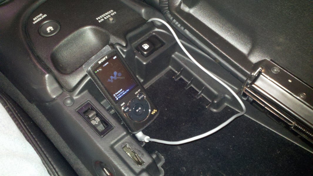

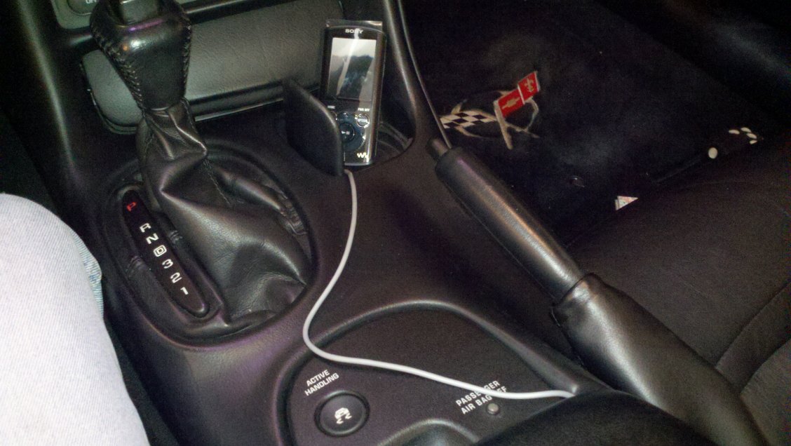

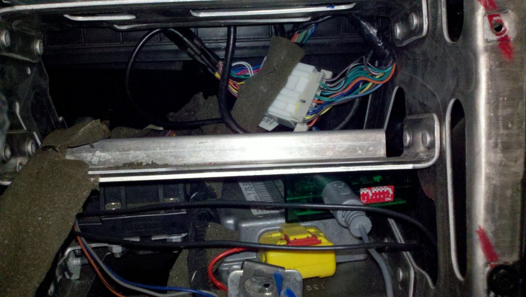

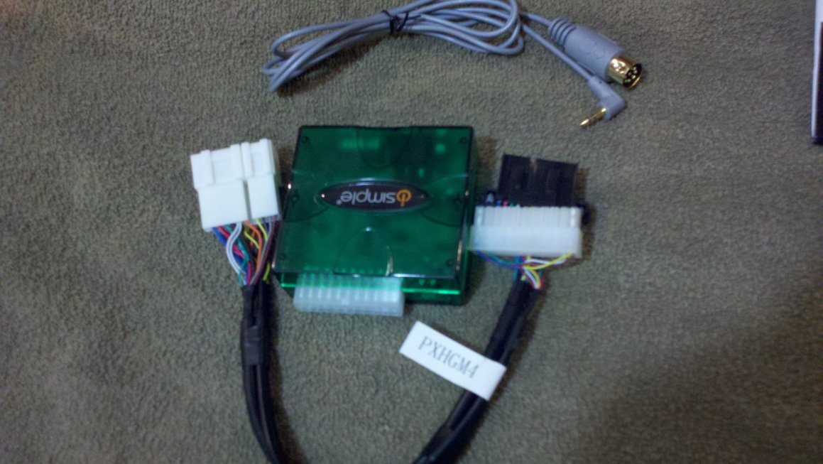

So, I got my harness and adapter from Double D Mods yesterday. They sent me the PXDX and PXHGM4 ($79.99 and free shipping). Expecting a "Peripheral", I got the "iSimple" This is the kit I need to pair my SONY MP3 player with the factory radio. If you have an IPOD, it will be a different harness. It took a lil over an hour as I had no clue how to take anything apart. I referred to CAC member Toque for the pictures on his site...a BIG help! Here is a list of things I learned on my own that may help someone in the future...
These pointers are relevant to my '04 convertible, automatic...
1. Other than having my garage heated now, I don't enjoy working on the Vette any more than I did my General Lee
2. Lay a towel over your dash/front vents etc. to help prevent scratches when the clips above the radio becomes unattached.
3. Remove key fob etc from key ring. I had to turn key on/off several times as to run shifter from park to lower gear position so I would be able to remove and reinstall center console.
4. I had to remove center LID only, not the whole piece that goes under the waterfall. I didn't have to mess with gas lid button.
5. Removing power point in console storage area: unplug wires, turn either way while gently pushing out. There is a notched opening on the top side of the console, and 2 knobs on the power point itself. Once the 1st knob is out, keep turning until the other knob is out. It gets reinstalled the same way.
6. Keep ash tray door shut at all times. It's very fragile and likes to get in the way.
7. There are 2 hook clips above the radio that hold the entire piece to the dash. These are molded and a part of the entire center console piece. There are also a few straight, molded guides to assure that the console trim gets in the correct place
8. My SONY E465 Mp3 player connects to the PXDX with the 2.5mm headphone jack, NOT the rectangle port that chargers and hooks to a USB....I CAN NOT use the radio controls to run the Mp3 player, as you apparently can with iPod. The PXDX will NOT charge my Sony E465.
I'm a bit disappointed that I can't use the radio controls to run the Mp3, but everything was easy to hook up, went back together easier than it came apart, and it ALL works! I wanted to share this info that may fill in some of the blanks that I did. I will try to add some pic's.

Going to try to ad some pic's of my install...2012-12-03_23-27-46_171.jpg2012-12-03_23-54-35_988.jpg2012-12-03_22-37-55_843.jpg
