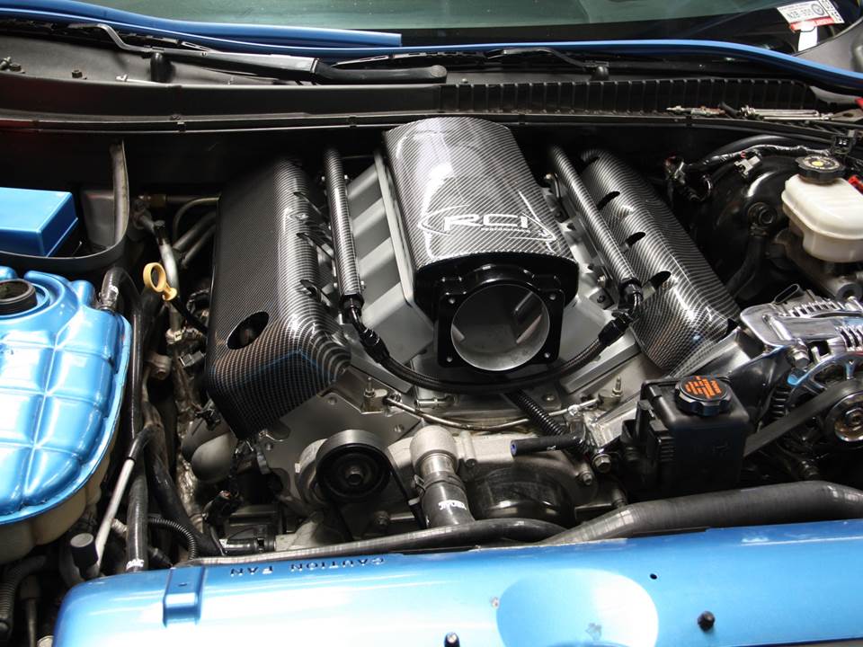

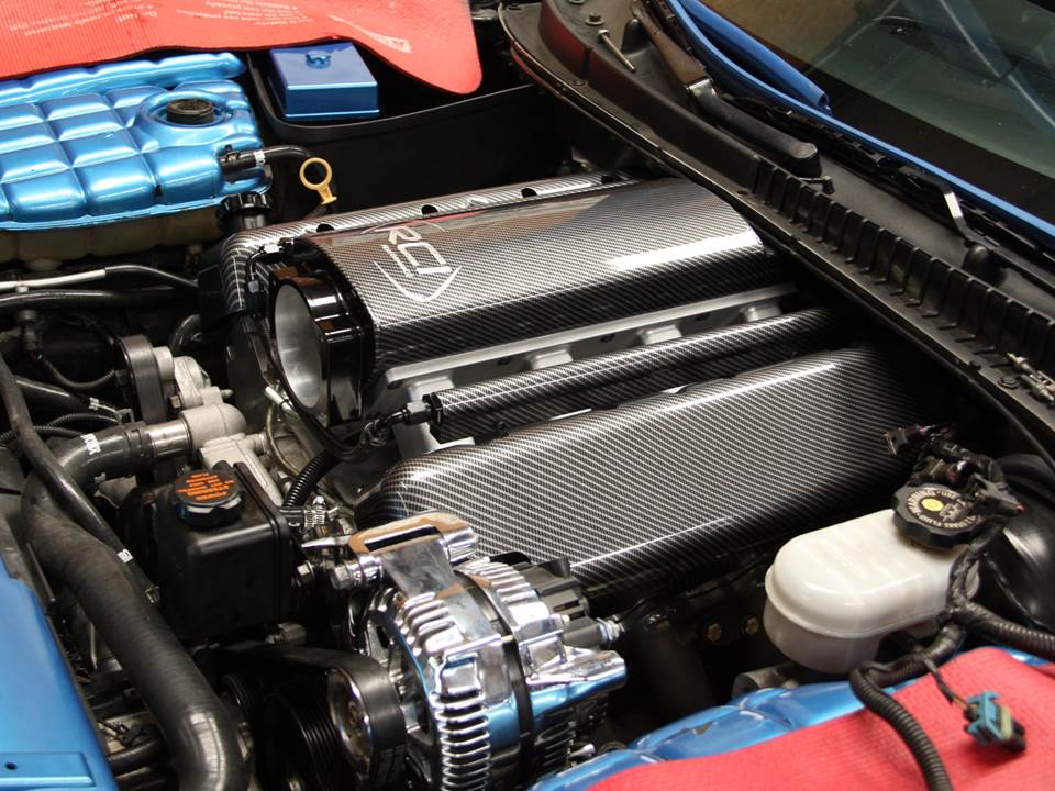

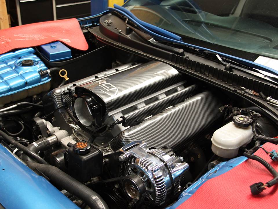

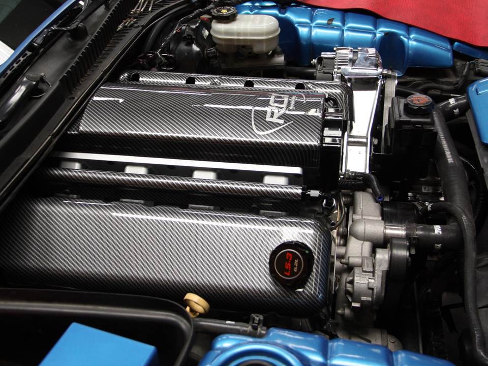

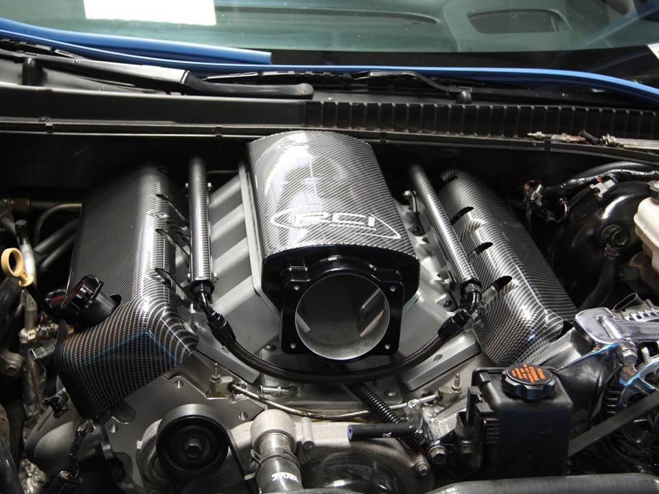

New MODs to my 1999 C5 Coupe almost finished. . . . . (MOD List Below):
RCI Performance
RCI Performance | LS and LSX Performance Parts
1. Engine Block – 2010,LS3, 6.2 Liter (Stroker) 427 cu. in.
2. Heads - Stock LS3, Ported, Polished & CNC
3. Intake Manifold - RCI Custom Intake System
4. Throttle Body - GM LS290mm
5. Camshaft – “CAM Motion Performance Cam”
a. Duration @ .050:229 x 244
b. Valve Lift: .615 x .595
c. Lobe Separation Angle (LSA): 113.
d. LS7 Roller Lifters and Pushrods
6. Crankshaft - SCAT Forged Crank: 4.124” Stroke w/24 Tooth Reluctor Gear.
7. Connecting Rods: SCAT Forged Rods
8. Pistons: Diamond Pistons & Rings

Looks good, real good.
Auto or M6 and what rear gear?
Any idea what she'll make at the tires?

I'm running the stock M6 six speed, with stock 3.42 gears. Right now she's putting down 535 RWHP, but the stock LS1 Fuel Pump started losing pressure @ 5000 RPM so couldn't finish the Dyno tune until a new "Performance Fuel Pump" can be installed. Also I'm replacing the twin disk clutch I had installed about a year and a half ago with LS7 clutch. The twin disk just hasn't been a very good street setup. . . . . (not for me anyway).
