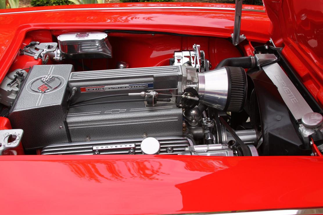

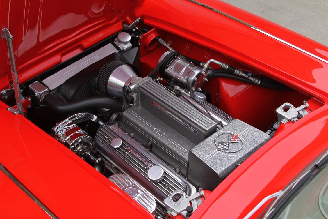

Engine compartment completed. :w

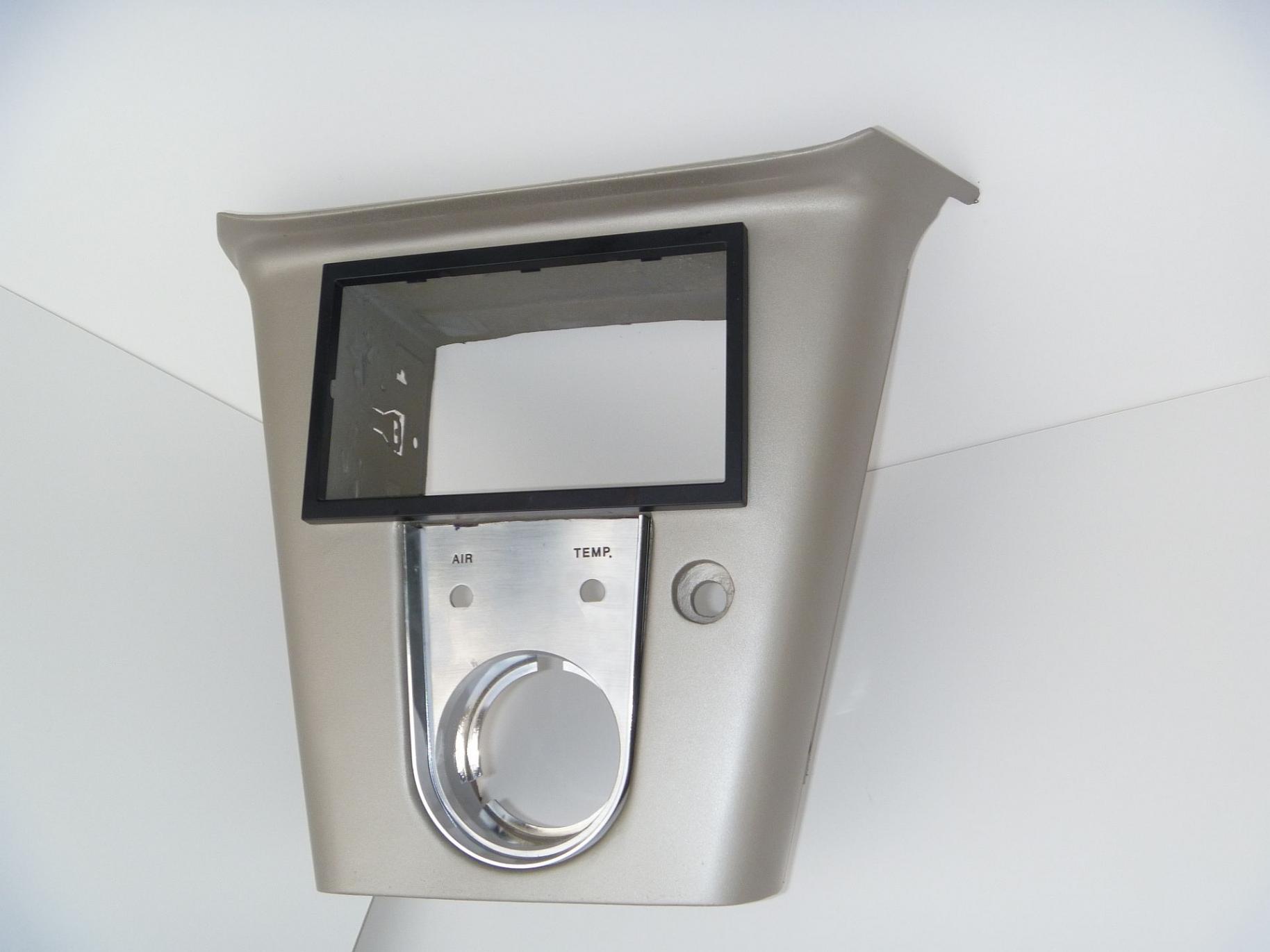

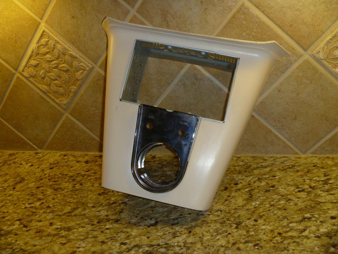

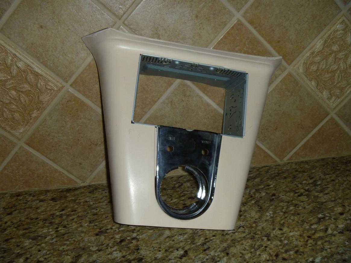

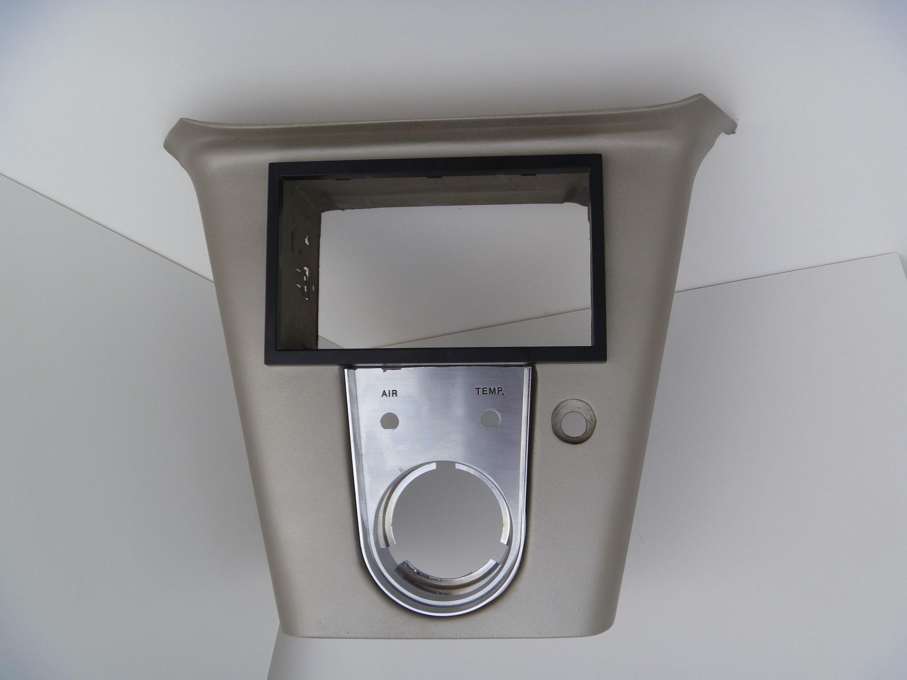

I have begun to rough fit the new navigation system. :w
It is an Alpine INA-W900BT. It has bluetooth, indash GPS, navigation, USB, DVD, IPod, MP3 and AM/FM.
It took three different vendors and over three months to finally get the fiberglass console.
I did not want to use the original console and heater/clock control plate - in case I messed up and down time.
After fine fitting, I will paint the fiberglass to match the existing Fawn Beige interior.
Don't know when I will be removing the existing set up - hot North Carolina weather is now upon us and
laying under the dash will not be fun. But I will post as things progress.
Roger

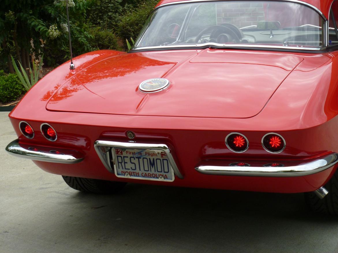

I installed LED tail lights in the 62. The photo was taken in bright sunlight and the parking lights were on.
They are much brighter with the brakes/turn signals. :w

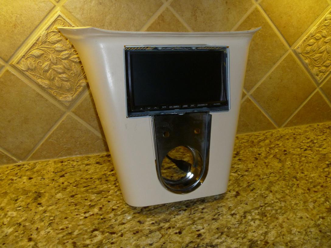

Progress on the center console to mount the Nav/DVD/AM/FM. :w Hole to the right is for the ac outlet or defrost.

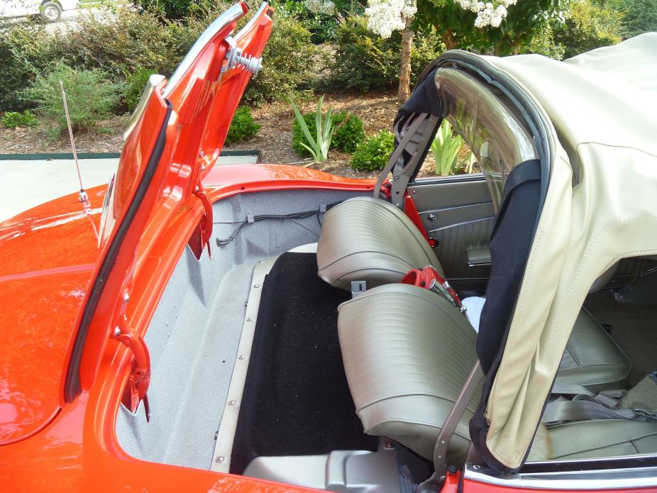

Took the hardtop off to fit it to the ceiling mount. Of course it was 95 degrees today and 100 tomorrow, so working outside will not be pleasant. :w

62 Corvette Soft top and top down. :w
