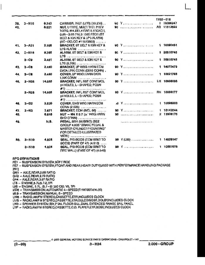

This is GM Parts Schematic - NO ELECTRONICS / SWITCHES INDICATED however.
Will check other sections of GM Parts Manual, or FSM ('90) Will take a while to flip through here...

vig - I don't see text "seat belt switch" in any of the 10 parts' descriptions'.
#4 SEALING STRIP, F/SEAT ANC (buzzer announce? announcer? announcement? ANCHOR???).
I think I've seen an electrical connector in others I've owned. And the schematic says nothing about it - that I see.............)

yes I saw those on EBay, and I'm looking for a service manual diagram or picture of where this buzzer module is within the 90's console.
