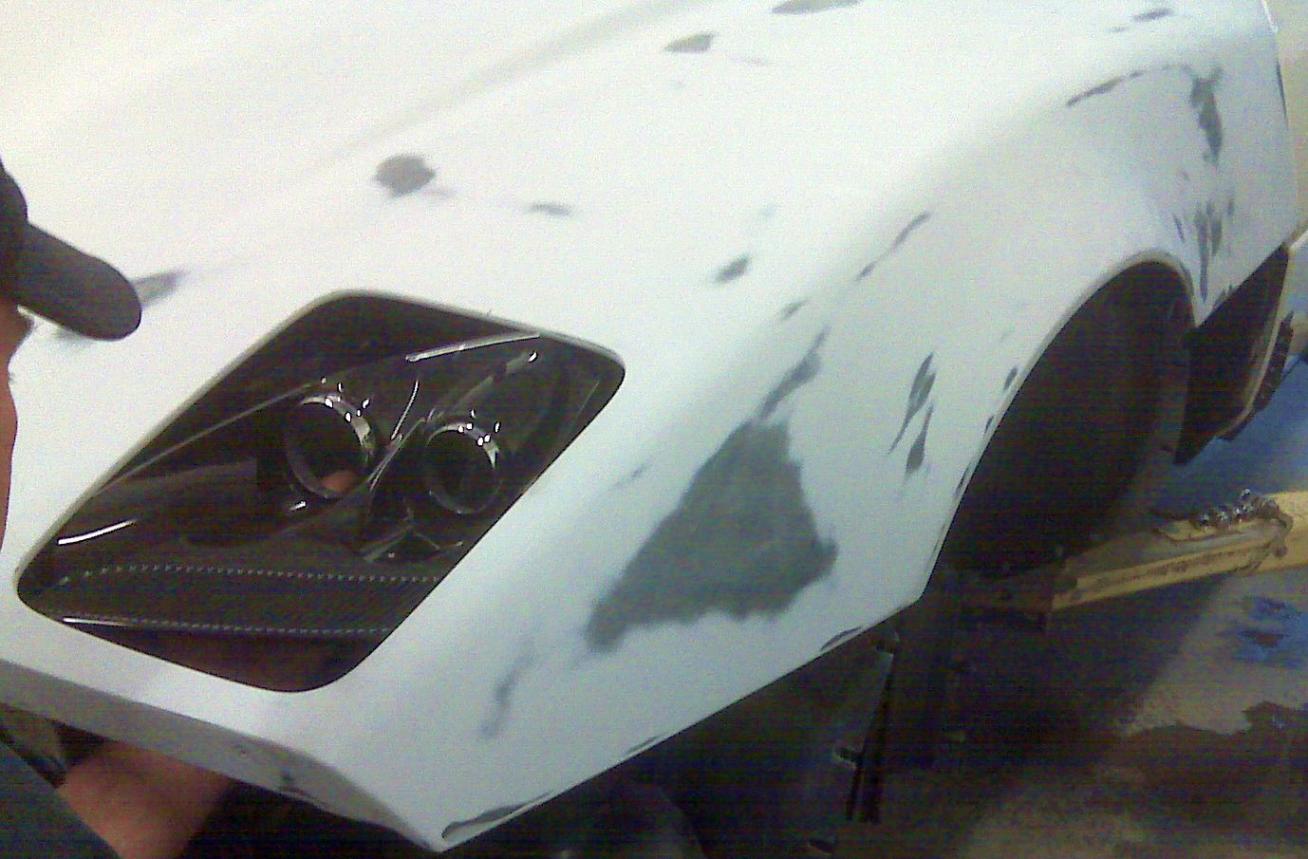

One black C6 headlight has been hacked up ('twas pretty broken already) and the second (silver) is supposed to be enroute. The intention is to mount these (carbon fiber redo) at the legal height, w/ or w/o 'bubbles' as the smallish lights demand, in their new, fixed mounts (from under, ala the stock 'flippers'. We'd like to make them simple to mount, in case others want them. During the hold-it-in-place test, OMG! :thumb

i would definately like to see the end result on these headlights i think with some good work it could look really nice and start a new trend

The upper section of the two-piece Shinoda rear bumper is very wavy; got more thin scratch coats of the flex filler to remove the low spots, as primer didn't. Now, I have sanded all parts in prep for the final coat of primer, each coat dusted with black "guide coat" spray paint. The minor waves in the body panel are much easier to see; probably impossible to feel, so the contrasting paint makes it much easier to get a perfect panel. The nose pic shows the start of that sanding process. Moderate pressure on the paper is okay, here and some bare poly shows up; a high spot.
All of that black gets sanded off (again) with 500-wet block-mounted paper to ensure that perfect base for the sealer and color. The last bit of guide coat is visible under Jerri's wrist, in the next pic. The idea is not to just remove the black traces, but to use it as a low-point guide in truing of the panel. This painting rookie can see improvement in every panel; the subtle kind that our eyes detect on show cars.
The water filled spray bottle gets a small dab of liquid dishwashing detergent for sanding ease. A clean towel dries and removes all sanding residue; oily prints are major no-nos and all parts get stowed in a safe place. A lighter touch is used here, allowing the grit on the paper to do the work
