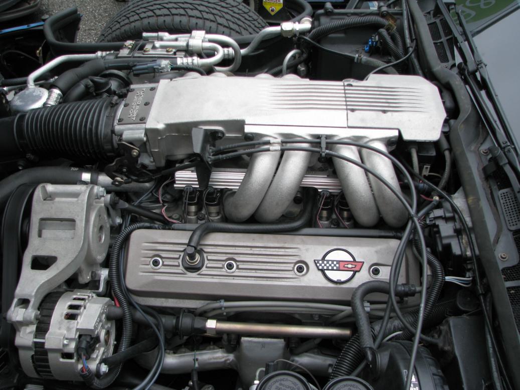

The first thing i did when i got my Corvette was drain the factory oil and put Mobil 1 5w 30 in.
